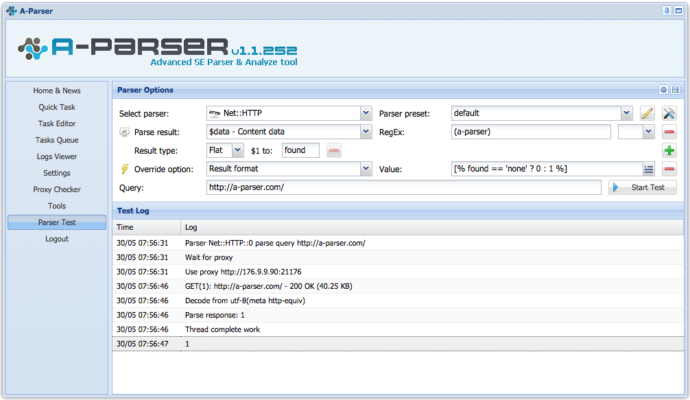

I'm having trouble putting everything together. Here is what I have:
I'm sure I'm missing something very simple and more than likely bungled the regex :-)
Basically, I want to check the search result page for the exact text I put in parenthesis in the regex field (I've tried it without the parenthesis too) and if it exists display a 1 and if not display 0.
Of the keywords in the queries box only the results for "how to kill fruit flies" should display a "1" and the others should display a "0" but any keyword I use displays a 1.
Looks like the data I'm trying to find is requires javascript to be rendered and I see in debug mode that the javascript is not rendered. There is no way to search the full source code of s SERP page?
For work with raw data in this parser it is necessary through to switch on the option Raw data results
Also instead of answer = 'none' need to be written check.0.answer == '' to Result format, as there is an address not to a variable, and to value in the array
No, the way to search the full source code of a SERP page doesn't exist.
