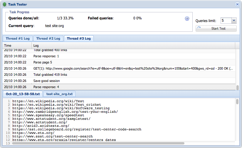

  • Added new Task Tester, allows testing all a task as a whole, including the use of multiple parsers, Results and Query Builders. The tester allows you to view the results for each created file, and displays the execution log for each query
