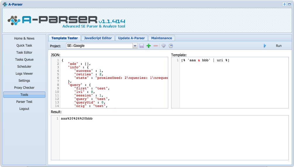

    I'm also having trouble with queries like:
    The "&" "+" and "#" characters don't seem to be passed/encoded properly.
    Also, when saving the file if a query has a "%" it won't be used in the filename even thought that is an acceptable character for Windows filenames.
    Even if I encode the query myself it's still not working properly but I need to be able to keep the query in orginal form in my query list and not encoded but just wanted to see what would happen if tested already encoded.

    you have to apply escape filter:
    this will be fixed also

    For the escape filter, I would need to create a filter for each character I am having issues with or is there a way to specify multiple characters in a single filter?
    Also, I'm not clear on where I put this in my task settings. The screenshot providing the example is for Google parser but I am using NET::Http parser?

    Just replace in our Query format $query to [% query | uri %]
    scrapefun likes this.

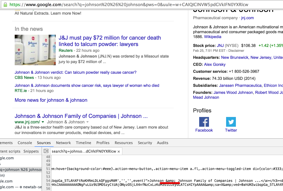

    I tested with the latest update and the file naming issues I was having seem to be fixed and most of the characters are passed fine after using the escape filter but I'm still having problems with some words.
    Mainly those containing "+", "&", "<", and ">" characters.
    Here are some examples with the original phrase on the left of the "=" and what is returned in the Google result page I'm downloading on the right:
    Granted some of these are pretty much nonsense for testing purposes but I need to be able to properly submit these characters. Could very well be I'm doing something wrong on my end of course :)

    It isn't proper symbols for HTML, you can't use < >(and several other symbols) directly in html. This is because you will get &lt; &gt; &amp; etc... This called "HTML-entities"
    Exactly same you will get from google in browser:

    Thanks for the explanation on that. I was just checking in my text editor instead of browser so didn't see those rendered correctly.
