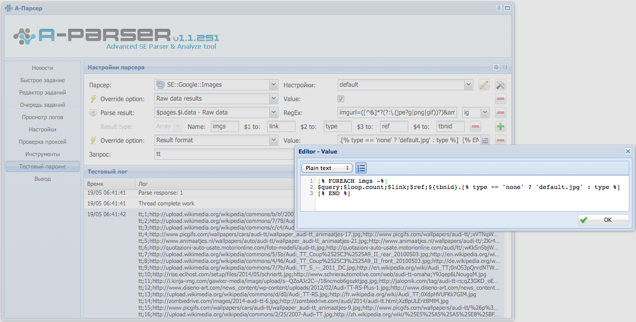

    Very interesting solution:
    • Use SE::Google::Images SE::Google::Images + Raw data results for generate queries and get raw html
    • Use complex regex to get all data
    • Use power of Result format for generate proper result

    Thanks! This works great.
    Is it possible to use the result of one parser to form the queries for another parser? I saw in the help files that it was not possible when the page was posted but wondered if it was possible yet?
    Basically, I want to use the net::http parser to download the actual image from Google images. I got it working as a stand alone task but I would like to be able to use the "$link" result value from the Google image parser as the query for the net:http parser.
    Thanks again for your help!

    What I am doing is creating an additional result file when scraping Google Images that just contains the image URLs and then I use those as the $query for the Net::HTTP parser in a separate task but with this method I can't match up the image to the original keyword query.
    I want to name the images with the query from the Google Images task. How do I match up the image to the correct query the Google Image parser task?

    As the request file, select obtained in the previous task file.
    The result is img folder with a pictures, named by keyword and number.
